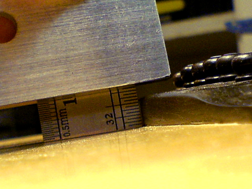

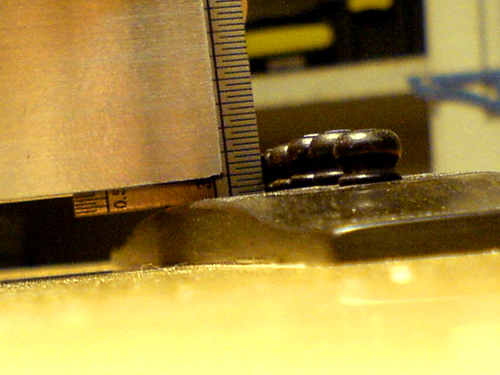

Here are a couple of images that might clarify things:
In both images, the straightedge is lying along the neck centerline, and is 1/8" clear of the bridge. The back angle I mentioned is in the saddle, which seemed like a good idea at the time, in order to resist the saddle's tendency to roll forward over time.

Thanks Ken for measuring the neck angle and taking photos of it for us.
I am hoping that others will weigh-in here because I don't want to give you bad advice.
To me what you should do to fix this depends entirely on your own personal guitar building goals.  If this is your first of potentially many guitars I would do one thing.  If this is possibly one of the only guitar that you will ever build I would do another.
I think that there are two things wrong here.  First the neck angle is to great, as evidenced by the straight edge 1/8" over a bridge that is not really to high (5/16").  The second thing that is not right is the location of the saddle and the inability to properly intonate the guitar.
If you re-route a wider saddle slot in the proper location and without any back lean you will still have half the saddle above the bridge and this can cause the bridge to split as the saddle gets pulled forward.
If you route off the bridge, replace it with a taller one, your string height will remain to high, again to much forward pull on the saddle, and if the saddle does not split the bridge the bridge may lift in the back.
So in a perfect world I would re-set the neck to the proper, lower angle first.  Then if I could re-route the bridge slot in the proper location I would.  If not I would replace the bridge.
The neck re-set may seem daunting and I didn't want to take one on either on my first guitar that could have benefited from one.  So I waited until I had more experience.
So if this is your one-an-only and you want it to be perfect I think that it starts with correcting the neck angle.  If you are going to keep building, and I hope that you will, I would get started on the next guitar and try the saddle re-slot for now until you feel up to a neck reset.  And of course what the others have said that things may change favorably over time with the guitar may happen too.
Don't feel bad though I doubt that very many of us at all get the neck angle right on the first guitar - I didn't either.
Also this idea of having a saddle leaning back at an angle although a very good idea and a great way IMHO to belay the effects of torque on a saddle and bridge is not a beginning technique.  In your case it is likely what caused the bridge to not be located properly since it is the saddle top edge that needed to be located properly and you had no way to know in advance where that would be.  The leaning saddle was in a way a moving target for you.
Let's see what more experienced people say and maybe they will be OK with the neck angle and I am being to alarmist here.
